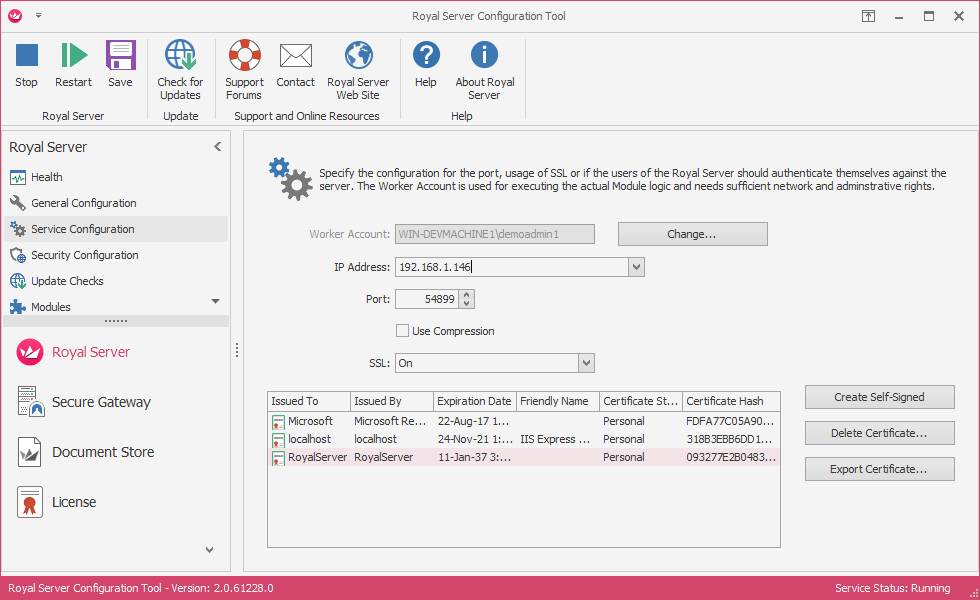

Worker Account
After the Royal ServerConfiguration Tool has been launched, it is strongly recommended to set a Worker Account. Royal Server is running as a Windows Service and as such is using the Local System account. But for the commands Royal Server is executing, a Worker Account is used. It is vital, that this account has network access rights, otherwise Royal Server is unable to manage your servers.
Port
Configuration of the port Royal Server is using
Use Compression
If checked, Royal Server compresses the traffic to save bandwidth.
SSL
Set it to “On” if you need the communication between Royal TS/X and Royal Server to be encrypted. You have to select a pre-installed suitable certificate from the list or create a self-signed certificate with a single click.

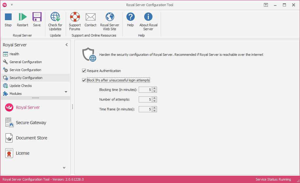

Require Authentication
If you want to restrict access to Royal Server, you can check “Require Authentication”. If checked, Royal Server only accepts requests from users who are members of the local group “Royal Server Users” (which will be created automatically on installation). By default, the setup puts the local Administrator in this group. In addition, you need to setup and assign this credential in the Royal TS/X Royal Server object. To improve performance when authentication is required, configure the Royal Server caching time (default is 5 minutes).
Block IPs after unsuccessful login attempts
Since Royal Server might be attacked if reachable in the internet, you can configure a blocking mechanism to block IPs that unsuccessfully tried to login too often.

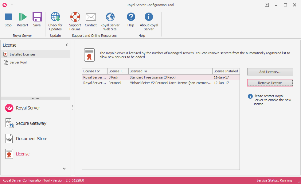

By default, a “Standard Free License (3 Pack)” is installed which allows you to manage 3 servers. Since version 2 of Royal Server we do not license by server anymore but just offer the following licenses which simplifies it alot and also aligns with Royal TS/X licenses:
For detailed information about licensing check out our Royal Server V2 FAQs.
Royal Server is keeping track of the servers you manage in the case you only have the “Standard Free License (3 Pack)” installed. In the Server Pool configuration, you can delete previously managed servers to free up licenses. This panel shows the number of managed servers you have licensed, how many are used already and how many free licenses are available. The column “Last Accessed” shows the last timestamp Royal Server accessed this server (this information is stored in memory and is not immediately available after the service was started).
